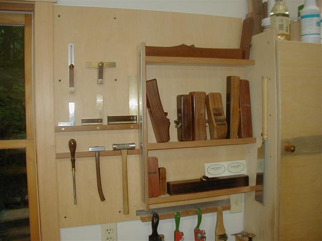

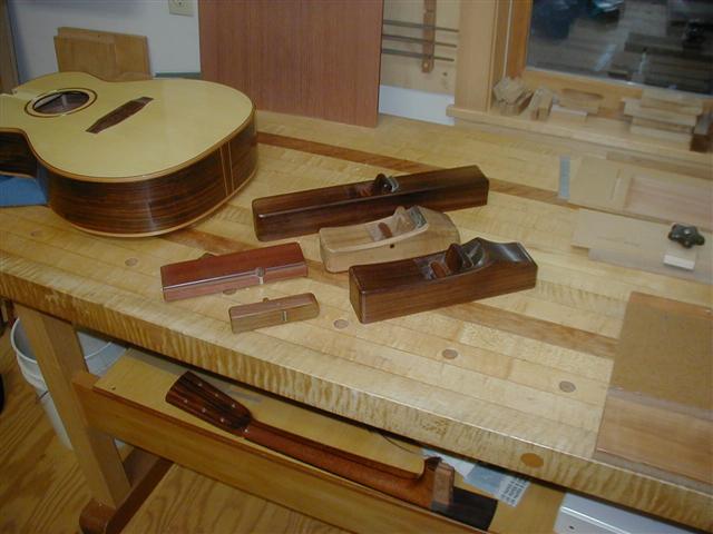

Posts: 785
Paul, those are really beautiful. Are they the Krenov design? I picked up a book on building a Krenov-style plane a while back, and I haven't gotten around to building one yet.
PostPosted: Wed Nov 08, 2006 11:38 pm
Posts: 639
I think I joined in that offer to show work in progress. I got stalled too. I have three in the works at various stages- two with genuine Zoot. Perhaps Paul and I could work together on visuals and text. I'm no master, but as some of you know, I love working with wood and steel in forms other than guitars.MT
PostPosted: Thu Nov 09, 2006 4:11 am
Posts: 260
Kelby, yes they are Krenov style. In fact I made most of them in the early 80's when I studied with Krenov at his school in California.
